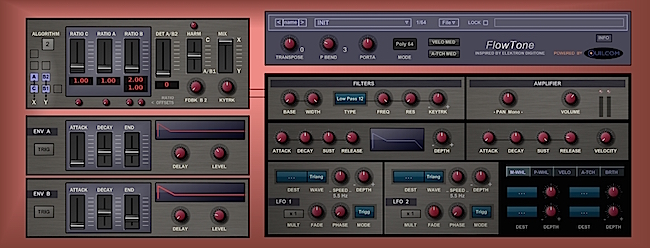

So, I'm getting close to finalizing this, but I've encountered a difficulty that I don't remember ever having before.
I added an additional item to the LFO's 'Mult' choices: "Kybd", where the LFO speed will track the keyboard. I got that all working fine, but when selected, the change won't take effect until any stream input inside the LFO is clicked on. Then have to do it again when switching back to normal ('x1').
I tried that weird '0 to output' thingy you came up with to address an issue with my 'maGGi' LFO; that doesn't work, then I tried force connecting an 'After Load' prim to a stream input, that doesn't do it either (?).

I fixed the issue (in LFO 1) and added comments to the schematic.
I’ve had this kinda thing happen before. When a schematic gets complex I think the timing between green and stream gets dodgy. I don’t know for sure about the cause, but the solution has always been to add a de-zipper, since that would appear to provide a correctly timed interface between green and stream.
I should add that I found it unpredictable as to when such a thing is needed, but my guess is that it’s trigger related. My thought is that the de-zipper triggers a priority read of the green value at the moment the poly channel opens.
Or... it’s a bug! :lol:

I guess I can call this v1.0 - Thanks Spogg for the zip-fix (I really should have thought to try that!); some additional GUI refinements (including lightening the Quilcom logo so it's easier to see), but main addition is Smart Labels for time readouts on the EG controls.
All EGs time scaled like minimoog - 10sec at max; 1 sec at center.
I suppose a version with FX is worth doing; we'll see if I have enough steam to go at it.
64bit version with four GUI sizes (by right-clicking on the 'FlowTone' label).
FlowTone v1.000 fs4.fsm.zip
(1.25 MiB) Downloaded 821 times
I welcome all feature ideas, criticisms, refinement suggestions, etc.

Just as a reminder - very little of this synth is my work - the concept and general structure is from the Elektron Digitone hardware synth, the Ratio controls, odd AD/End EGs, the non-standard LFO modes, and other odd bits are from the 'Mind of Spogg', the GUI is heavily based on Adam's Viper, and as usual Martin's work is liberally sprinkled throughout. It was really more of an 'IKEA assembly' on my part. I guess my main contribution was organizing the panel layout to put all the controls into one view in a clear and logical manner - emulation of the hardware in this respect was out of the question !

It occurred to me that one of the odder limitations of the Digitone is that, having only 5 mod sources, one of them would be Breath. Since this is an FM synth, and the Multimode Filter wouldn't be used all the time, as it would in a subtractive synth, a more useful 5th mod source would be the Filter EG. So I made the 'Breath' button in the mod section toggle-able to 'FEG' by right-clicking it.
Since the 'hidden' right-click button blocks the left-click action in the area of the text, one has to click on an area of the button not covered by the 'Brth' label in order to select those mod controls. Is there a way to make that 'hidden' selector 'invisible' to left-click, so one doesn't have to click only outside the text to do this?
