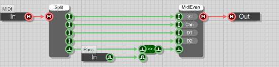

Sorry... i didn't mean the code from above but the concept of passing the messages you don't want to filter or treat...
def event i
  m = @midiInput.to_array
  if (m[0] == 144) || (m[0] == 128)
     output Midi.new m[0],m[1],m[2],m[3] if m[2]>@thresh1
  else
  end
end
If the status is 128 or 144 then apply the filter on the event... otherwise let it pass...
"output Midi.new m[0],m[1],m[2],m[3]" is the equivlent of "MIDI.send(type,d1,d2,channel)" in the Arduino/Teensy code.
FYI - on the green side but unrelated to your issue; you only need a trigger switch on the trigger stream... the MIDI split and event primitives can have their integer values connected directly and it will only be output when the trigger is allowed through by the (single) switch.
