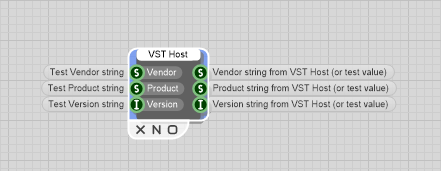

oh, and please add a prim to read out which DAW is in use!
@spogg would it be asked too much to make a list in the first post? so the devs would not have to read the whole thread, and users do not need to repeat others
Re: Flowstone wishlist
Well... that's already there
- there.png (14.05 KiB) Viewed 35133 times
