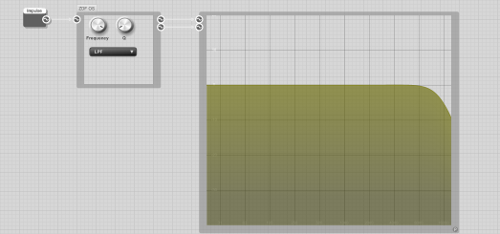

here's screenshot
- screenshot.png (51.57 KiB) Viewed 30197 times
Re: Zero Delay Feedback Filter
i see that, but what happens to the yellow curve when you change filter type to BP or HP?
*Edit: Here with me your second fix shows that the yellow curve is warped and the disappear near 20khz and the grey curve just stays at LP filter type.
