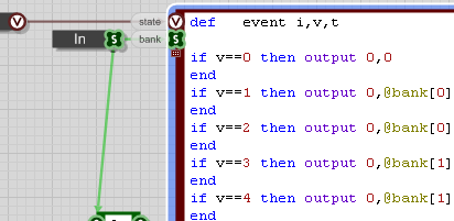

Need some 'ruby ' advice on some suspect code i got.....
This code works.
But to me, code is wrong....
I'm not telling ruby which input is "v"...
Should read 'if @state' , not 'if v'
But code works....
my question is....
should i bother changing it.....will it make a difference..???
I have about 60 of these in important positions in fsm...
EDIT:
Ok..so why does it work..??
Because @bank is used in the code...
So ruby automaticly process next available input as 'v'...??
So is ruby working harder to calculate this within the code...??

Re: New Synth: X11
You might need to change your 'suspect' code.
'v' is always the value of whichever input just changed - so it will work fine when the value of '@state' changes. But when the '@bank' input changes the code won't do anything because 'v' will contain the array, which can't be compared to a Integer. So you would be better off using the '@state' variable - that way, when the array changes, it will still look up the correct index.
