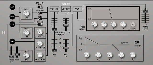

Latest Toneboardz - Section II Total level, not showing values under the slider.
- Untitled 2.jpg (41.37 KiB) Viewed 30292 times
Ooops - thanks for catching that.

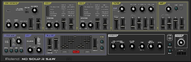

Here's an example of the kind of thing that would prompt me to do a new build. I was checking out what instruments various members of this and other forums used and saw that Knob Twiddler had a JP-8000. Didn't know anything about it, so in checking it out was very intrigued by it's Sawtooth re-shaping control - I've never encountered anything quite like it. It morphs from a sine-boosted saw, to pure saw, to saw with fundamental weakened by an inverted sine, to pure sine, to sine-boosted ramp - all via a single slider! And the wave-shifting can be LFO-modulated! One immediately thinks: "Hmm, how could I do that with Synthmaker?".
Other waves also interesting: a triangle with modulatable wavefolding and Noise with it's own dedicated LPF. I didn't include the JP's famous (infamous?) SuperSaw both because I'm sick of hearing that sound, but mostly because doing a supersaw in Synthmaker results in too-high CPU load. The Feedback wave I didn't do simply because the manual is too vague about exactly what it was, and without the instrument here to listen to - no idea what it actually sounded like.
The JP's panel design I found rather unattractive (not crazy about black and blue panels) and since I noticed a distinct similarity between it's structure and that of Gaia, I adapted those panel graphics for -
Rolend noSoupRsaw :
Rolend noSoupRsaw :
