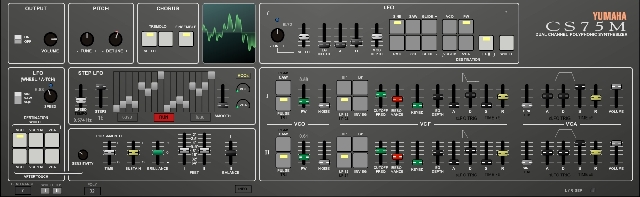

Another Yammy - this one based on a pretty obscure model, I believe the last analog Yamaha put out just before the DX7, the CS-70M. Personally I think these last CS polysynths were pretty unattractive, so did it up in CS-80 livery.
Yumaha CS-75M :
Yumaha CS-75M_copy.jpg (80.51 KiB) Viewed 28018 times
I added the ability of each Channel's Sine to FM the other; the depth being controlled by the Filter EGs. Also more waveforms, extended 'Footage' ranges and filter keytrack which the CS-70M inexplicably lacked.
Probably it's most interesting feature was it's dedicated Wheel/Aftertouch LFO in addition to the main LFO. The main LFO's controls are a bit unusual, so be sure to read the 'Info' box and maybe refer to the included CS-70M manual.
