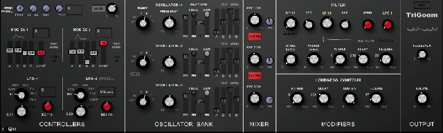

In the meantime here's one that wasn't in the original Bundle because it wasn't finished yet. Inspired initially by the DIY hardware synth, Goom. It had an interesting signal path, but no LFO! So I expanded it to three oscillators and gave it two freely assignable LFOs (one through the mod wheel) and two freely assignable Mod EGs. I implemented the oscillators as my favorite three-control multiwave (blendable Sine/Tri/Peak/Saw/Pulse). The filter is CS-80-style HP in series with LP (2 or 4-pole), with dedicated IL/AL/A/D/R envelope. I call it TriGoom.
Since the name Goom was clearly a wink at Moog, I did this up in minimoog-style livery (no, it doesn't SOUND like a minimoog!!, OK?

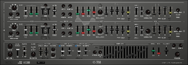

Regarding Spogg's question a while back about have I done a 'dream synth' - the closest I've come I suppose is this one I just finished tidying up. It's certainly not 'all my own', but rather based on a daydream of a Yamaha that combined most of the features of several CS-series synths. The mighty CS-80 was mighty because of it's truly polyphonic touch response and plethora of performance controls; it's basic synthesis abilities were surpassed by most of the other CS synths, especially the monophonic ones like CS-15 and CS-30.
So, the idea was to do a plugin that combined many features of CS-30, CS-15 and CS-80 in a CS-80-style panel layout.
Therefore CS-358 :

BTW I love your dream synth!

Glad you like CS-358 - it's pretty deep; a lot more going on than it seems at first glance. Re-download it - I just realized I mislabeled the button at bottom left "Bend Wheel" - should be "Mod Wheel"; I corrected it. I also included in the folder the CS-30 and CS-15 manuals - could be helpful.

Re-download CS-358 - I've re-done the panel with the name text burned-in as an image (so the unusual font appears correctly on any computer), and made most of the mod selects with larger, clearer text. Also removed the Brilliance I/I+II/II selector and added the global Reo slider, like CS-80 had. See revised image in earlier post.
