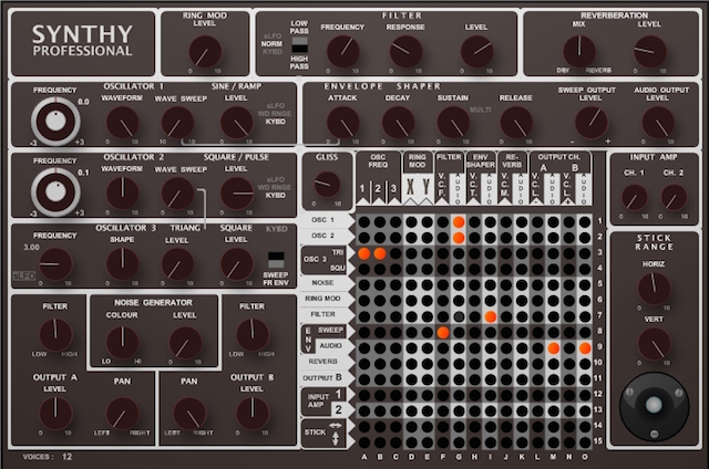

Finally got Synthy P param-named (and a visible Preset Manager), in the process did a major re-vamp (mostly error-corrections ;-] ). Oscillator three can toggle to a step LFO.
The Preset Manager appears at the bottom; I just didn't include it in the screenshot.
Synthy P copy.jpg (259.79 KiB) Viewed 28381 times
Thanks again to bluesmoke for all the hard work naming the pin matrix.
Posted: Thu Nov 17, 2016 8:54 am
I decided while I was at it I'd do a version of Synthy P that has a single envelope like the hardware. I've re-named the first version Synthy P_2eg, and this new one will now be called simply Synthy P.
If I understand the photos of Synthi P, there was a position midway on the Sustain knob that switched the envelope to a repeating mode; this position was marked "Multi". I've emulated this on this new version - at about 2:00 the Sustain knob has a mild detent, where the envelope goes into A/D loop mode.
Synthy P copy.jpg (266.51 KiB) Viewed 28269 times
