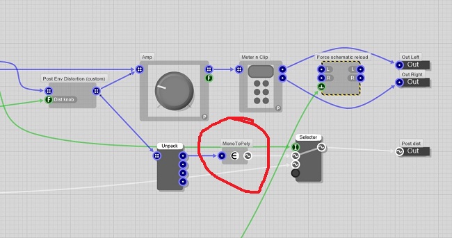

Whats causing the instability?
- This one bothered me...

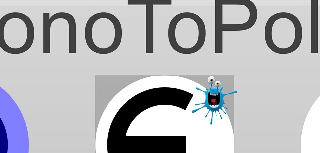

- So I zoomed in... and... There it is!

Jokes aside...
The mono2poly seems dodgy.
I think I only use like... 3 of them. Two for free running LFO and one for a scope.
Got rid of the above one for the scope. I could run the blue almost directly to the scopes graph prim instead because of an earlier change.
Think I gained back "some" stability by removing this mono2poly. But have to test more. Waiting for FS license to download 3.06 as recommended.
Me placing this particular mono2poly so late in the schematic and feeding earlier modules and prims with it might have caused unnecessary timing issues maybe.
Problem is still the free runnning LFO's.

Does DSP catch stream data from elsewhere other than the schematic connections to them?
I placed a DSP after a selector and still it recieves stream data even when selector is on another input. Magic?
R&R wrote:Does DSP catch stream data from elsewhere other than the schematic connections to them?
You’ve reminded me of something I used to occasionally see in 3.08.1 but not in 3.06. That would be corruption of the selector prim’s code when copy-pasting parts of the schematic with selectors in. To fix it I would first close and re-open FS and if that didn’t work I would bring in a new selector prim and swap links then delete the faulty one. What you’re describing shouldn’t happen!

Thanks Spogg! Good to know that the selector is the cause in this case...
Yes reopening project reloading schematic entirely is what ususally fixes observed ghost interaction.
Apparently in this case it doesn't.
