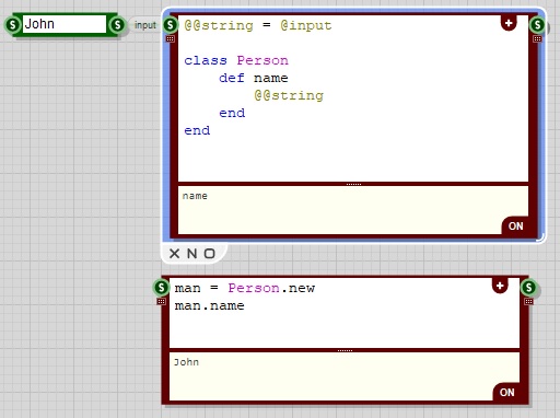

So I have been experimenting, and what I would like to achieve is to have the ability to change a variable inside a class from the outside, which then sends that to multiple RubyEdits. The only way I found is to use global variables but that is quite dangerous, is there a more elegant way? Is there a "self" method or something? I havent found any answers online
Thank you!
Thank you!

Re: Ruby Class help
adamszabo wrote:So I have been experimenting, and what I would like to achieve is to have the ability to change a variable inside a class from the outside, which then sends that to multiple RubyEdits. The only way I found is to use global variables but that is quite dangerous, is there a more elegant way? Is there a "self" method or something? I havent found any answers online
Thank you!
A class definition exists for all RubyEdits. A class instance however, only exists for the specific RubyEdit. You want all instances of a class to react to one change to a class definition? Or to a change in an instance (like setting the name "john" in one instance in RubyEdit A, and all instances in RubyEdit A and all instances in RubyEdit B update their name to "john"? Can you lay out a use case for what you try?
What you used there is not a global variable. You used a class variable. (@var = class instance variable, @@var = class variable). In this case a class variable that belongs to the RubyEdit class (not instance). That's only dangerous if you are not taking care of proper naming.
Re: Ruby Class help
Ah I see, what I meant was the @@ is a class variable. The problem with that is if I change that value, it will be seen all across the ruby, so if I open multiple VST plugins in a host for example, then all the instanced will change. Thats is not really what I am after. What I would like is your first example. So I will have this RubyEdit in multiple locations copied:
Sure, I could connect a string input for each of them and send "John" to all, but since they will anyway get the same name, it would be more elegant to change it "inside" the class Person itself, however for that RubyEdit, I would like to get that name from an outside string like in the picture.
man = Person.new
man.nameSure, I could connect a string input for each of them and send "John" to all, but since they will anyway get the same name, it would be more elegant to change it "inside" the class Person itself, however for that RubyEdit, I would like to get that name from an outside string like in the picture.
