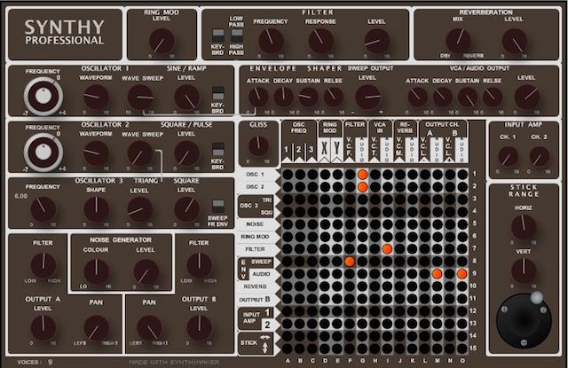

I'm probably going to be shot down here but what about cross-fading, based on the cut-off control, between a 3 pole and a 4 pole filter?
I shall await a smack round the head
That's what I did in the Synthy P - only I cross-faded between a 12dB and 24dB.
