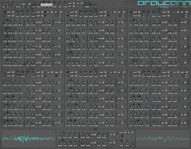

btw here is the reaktor version.
it has tooltips for everything like the one on top left, if you can see it, and it also features visual info for all the envelopes and lfos and of the math calculations between them (those thin blue lines if you can see them)
its extremely optimized but that was a lot of work, i admit.
