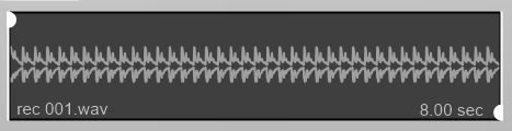

Here's two recordings of the "same" session. 120BPM, 4 bars:
rec 001.zip
(1.3 MiB) Downloaded 964 times
rec 002.zip
(1.3 MiB) Downloaded 921 times
they seems equal, but they are not (try the null test I've suggested above). Thus, neither inside FlowStone MIDI/Ruby/Audio seems to be SYNC :ugeek:

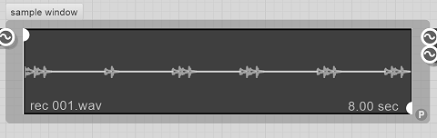

Here is the null->
original->

nix wrote:Here is the null->
Thats not null :shock: Theres a problem... isn't?

Yeah- something's up, it is very close though and almost cyclical

Yes its cyclical, but for "Session". I mean, those shot are recorded in parallel. If I record other 2 rec, the cyclical is again, but on different point.
Its a "random cyclical".
Even if its close, under heavy distortion plugin that could make huge differences...
