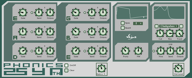

Heya tribe,
I have written a proprietary synth in this format now,
called 2SYNth, here is the UI->
2SYNth screen mid_0.png (107.05 KiB) Viewed 38927 times
It's real simple in architecture.
I will add a mono mode and tuned fm in the next couple of weeks.
Also, I found the ver1.7 of the MIDI one would play a tone out too much.
I have changed it again a little. Smoothing the Chebyshev was too slow.
Version 1.7.1 is in the download.
If you'd like to try it the d/l link in the first post has been updated.
I will make demos for both of these releases hopefully today.
