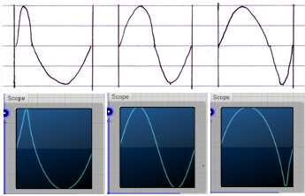

Here is a comparison of Spoggs sketches and phase modulation waveforms taken from my demo on page 1. Hmmm....

martinvicanek wrote:Here is a comparison of Spoggs sketches and phase modulation waveforms taken from my demo on page 1. Hmmm....
You can clearly see the difference. There are spikes where a curve should be. I don't know how to express it correctly in english, but the left line is "konkav" instead of "konvex" and the right line "konvex" instead of "konkav"

From the screenshots martin provided, it seems that derivative at x=0 and x=1 and x=mod is 1 (or at least equal). So the function for ramp distortion needs to satisfy following (mod is the parameter):
y(x)'=y(x+1)'{=y(mod)'=1} and y(0)=0 and y(1)=1 and y(mod)=0.5 ( what written in {} is just a guess).
I'm incapable of comming up with such a function... Martin? Tulamide? anyone?
We're coming closer. The second example indeed is continuous at the midpoint. So this could be the base to work with. I'm just afraid that you will take the example images from Martin, since they are not correct in the sense that they don't provide continuous waves. The curvature is reversed on one side (the left point on the first screen, the right point on the third screen). The wave should behave like in the irregular_sine_animated.fsm in terms of curvature.

I've given it some thought. The concavity is inevitable. Let's look at the third wave. It starts as a rather slow sine wave, which means it has low curvature. the end of the wave is a fast sine wave, which has high curvature. In order for the wave to joint smoothly, the curvature in the end has to drop, which results in that concavous shape.

Tulamide, why do you insist that the wave be convex in the upper half and concave in the lower? KG is right, such a requirement leaves very little headroom for modulation if you want the wave to have continuous slope at the joints. It feels unnatural to me, I don't see the rationale behind it.
