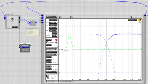

bidir IIR LR xover (500).png (68.65 KiB) Viewed 34019 times
How to implement a 4th-order Bessel lowpass, using the bidirectional IIR filtering?
Is there an IIR filter implementing the square root of a 4th-order Bessel lowpass?
Square root, because when executed "forward" then "reverse", it should equal a 4th-order Bessel.
Any advice welcome.

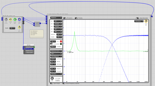

I made Q adjustable.
Almost no preshoot and ringing when Q set to 0.600
Real Fc = 1000 Hz when Fc knob set to 1230 Hz
Lowpass slope 4th-order like Linkwitz-Riley.
Highpass slope something like 2.5nd-order.
Looks okay. Makes me happy.

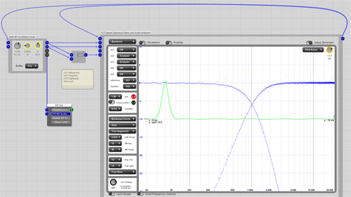

I made Q adjustable, and added knobs for adding a thin amount of bandpass energy and highpass energy in the woofer signal.
Real Fc = 1000 Hz when Fc knob set to 878 Hz
Lowpass slope something like 2.5th-order in the audio band.
Highpass slope something like 3rd-order.
Looks great. Makes me even more happy.
