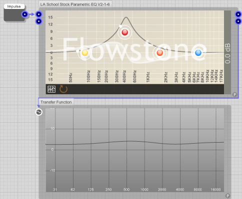

Hm, I am getting strange results here. The filter response is by no means what the curve suggests. When I crank up any of the bands by 15 dB, there is only a subtle change in the actual response. Variation of Q has almost no effect at all. BTW a narrow peak has a high Q and vice versa - in your display it is the other way round.

Re: Stock EQ V2
The displayed curve and the actual filter response are still very different:
- EQ-response.png (56.05 KiB) Viewed 21246 times

Re: Stock EQ V2
Ah yes, I had assumed as much. And this is the result of this just being "roughed". I still had yet to offset the initial high pass and low pass for each signal.
Like so:
In this illustration, the frequency is in the center like it should be. And prudently, the high and low pass are the result of the bell width. I merely need to add these calculations in. Rather than pixels or 0-1 value, I'll sort it by percentile so I can re-use the math if I ever want to use it for a vector GUI element.
Right now it looks like this:
I had put that off because I'd realized that it would take time to do. Thanks Martin. here's a new version that is a little bit faster. I took out the fancy curves of the links and cleaned up a lot of code. I believe though, that I could get this code to maybe 50kb. That would be ideal.
Here is the latest version:

Re: Stock EQ V2
I am not sure how your explanations relate to my observation above. Fact is that the modification dind't fix anything.

Re: Stock EQ V2
martinvicanek wrote:Hm, I am getting strange results here. The filter response is by no means what the curve suggests. When I crank up any of the bands by 15 dB, there is only a subtle change in the actual response. Variation of Q has almost no effect at all. BTW a narrow peak has a high Q and vice versa - in your display it is the other way round.
martinvicanek wrote:I am not sure how your explanations relate to my observation above. Fact is that the modification dind't fix anything.
Yeah, it's because only half the bell is actually affecting the sound. There is very little affect by this equalizer as yet. But I am meaning to do it; It's just an annoying pre-requisite that was straight-forward in nature. I'd realized I would have to do it eventually. For the time being I'm focusing on application, accuracy of the gauges and visual aids as well as the oversampling technique.
