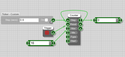

Re: home brew sequencer
Hi boys!
I wonder, what influence has a green counter on the Ruby ticker accuracy?
Can someone answer to this question? Because I'm not sure yet on this issue.
However in my opinion, a green counter should not be influence a Ruby ticker.
Hello support!
Heya Pall!
In my opinion-
Once u have ASIO running the custom ticker will be quite accurate.
The actual Ruby interval should be on the same amount of samples.
So your tick is not bang on the mark because of the green components,
but it will not drift further out in time.
The core of the timer is accurate.
nix wrote:tick is not bang on the mark because of the green components,but it will not drift further out in time
Aha...
Thanks Nick!
I will try to do some tests.
Would be nice if someone would make a counter in Ruby.
Cheers!
