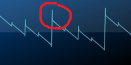

Posted: Wed Mar 15, 2023 12:55 pm
by R&R
I could use some descriptive parameter naming help...
What would one call this simple subtraction removing the saw but keeping the transient (2 samples)... if it was a knob?
Contains the fundamentals of the saw... but obviously retains HF.
Any suggestions?
This parameter will be another pain in the a** to add. :? Why did I have to add so many routings... :roll:
Edit:
Not sure if I should double samples by samplerate either...
Edit #2:
MV, the gift that keeps giving. His "interpolated delay saves the day" 8-)

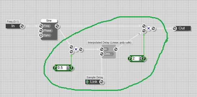

Posted: Mon Mar 27, 2023 11:22 am
by R&R
MV if you haven't tired of me completely yet ;)
But someone else might also be able to help me answer this...
Does the parts circled in green cost more or less than a single toolbox sine?
Trying to get some freebies without too much CPU cost.
But can't measure or count operations on a toolbox sine since it's wavetable I guess...
Posted: Mon Mar 27, 2023 2:03 pm
by R&R
R&R wrote:MV if you haven't tired of me completely yet ;)
Hmmm...
Darn it! Looks like toolbox sine wins this round :|
Posted: Mon Mar 27, 2023 3:17 pm
by R&R
8-)
Looks like Tepeix delay found here: http://www.dsprobotics.com/support/view ... 37#p237237 was quite fast... Nice job!
I didn't seem to beat using a second toolbox sine with phase offset in my particular scenario. But is seems slightly faster than MVs variant so it's really useful for the slice.
Don't know if there is a compromise or difference in their outputs (these two interpolated delays)...

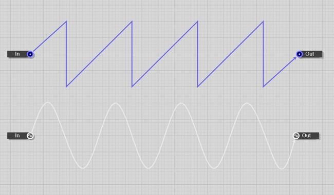

Posted: Wed Mar 29, 2023 10:24 am
by R&R
R&R wrote:Trying to reduce and micro-optimize some more.
Would be really nice to use the syncable LFO oscillators that Spogg posted earlier...
The transition time seems like a great option instead of the toolbox smoothing I resorted to.
Don't know if you can help me with this one also Martin? In case you're very restless maybe ;)
I won't be doing my own ASM any time soon :lol:
The issue preventing me from using them was (if I remember) that these LFO Osc's don't offset phase when receiving sync.
Yaaay! The "copy-paste-ASM-destroyer" (me) of anything optimized strikes again! :D
Managed to get these working in my scenario.
Will try and replace all of my toolbox Tri and Sines with MVs LFO Sine... even though it has some harmonic distortion... or whatever those extra harmonics are in it's output :? :lol:
Gonna take a crack at that master sync oscillator ASM to see If I can't Frankenstein that one as well :D
Posted: Wed Mar 29, 2023 11:15 am
by R&R
Will making every connection this way improve the sound of my plugin?
