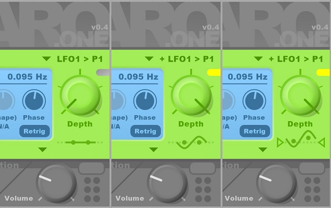

Splendid... That vector slider did the job...
Wasn't planning on having these two parameters at all from the start :roll: But felt I had to squeeze them in on each routing due to some changes.
This is as much slider as my stomach can handle I think :)

v0.4 done :roll:
