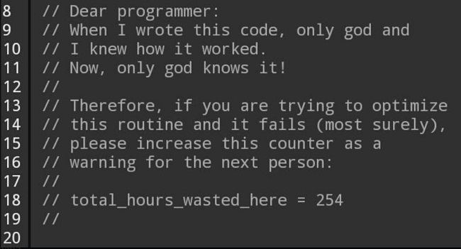

I'll end this side of christmas by posting this comment from the code of christmas past... or was it ghost?
