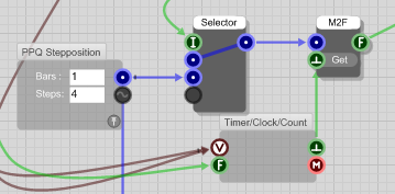

So the new sync module works pretty good! It doesnt crash the host when you change tempos much but I think its down to the mono2graph trying to grab x samples when x is changing!
The ppq ticker works well (must say its an accomplishment of yours!) but it still drifts slightly. Check the schm:
Test Beat.fsm
(16.28 KiB) Downloaded 1918 times
It seems that even though its accurate its still drifting around the sample start. Its an improvement tho :lol:

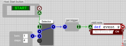

billv wrote: modify the ruby ticker, writing the ppq into the step parameter
Further on this...
See this part where the delivery happens...
 output 1,on
output 1,off,t+0.125
We need to have something in there that says
Check if output is allowed via (PPQ code that needs to be "created" or written in somewhere), and then output.
It seems really simple in theory.....perfectly sane and logical to me....
I havn't got the ruby skills at the moment, so only a ruby guru can finish that idea.....
(another good reason for me to keep this issue on a backburner, and work on other stuff...)
I hope I'm wrong, because if I'm right, then DSPR have probably successfully done the same thing, and will
not bail us out cause were so close. :lol: :lol:

billv wrote:havn't got the ruby skills at the moment, so only a ruby guru can finish that idea.
No need for the ruby skills...I created the idea in green and it works. :D :D :D
It uses 2 ruby tickers, and tempo changes are in sync.
And there's no PPQ Module. In short, I've created a small automation circuit,
(in theory similar to the X11 system), to handle that PPQ Sync.
This is the first working version, I've got some more ideas to better it still.
. Maybe a few more tweaks here and there.....
X11 2.01_v3_Timer.fsm
(35.68 KiB) Downloaded 1917 times

@billv:
the problem with your last examples is when you dont start playing on a barstart the position of the notes are always offset -
they do not syncronise to the ppq position, and it also starts playing always from the first position of your seqence, doesnt matter where in the host you start playing -
for example you go to positio 2.3.2.109 in your host and start playing from there, so your sequence will start here which gives you an offset, so it is never ppq position synced when you not start playing exactly on a barstart ( or what ever position is needed to start from depending on the beatfraction you are using)
for test turn off the snap to raster in your host and start from any position somwhere in between the some beats,
so your examples are useful when using a note arp because this should always start on the position where the note starts and not where you are in your host
but not when it should be always synced to the ppq position, like when using stepsequencers or steplfos -
lets say you start on position 1.2.2.0 with a resolution of quaternotes and a four step sequence, the next played note should be the 3rd note of your sequence at position 1.3.1.0, right, so there fore you need an exact position
in this example it would work right - there is just one issue: trogs ppq is precalced and have a delay compensation therefore it always sends a tick at start playing because the first step wouldnd be read because of the precalc - so when you start from somewhere in your host it always sends 1signal at start playing which is not in sync but the second is already synced to the ppq position
