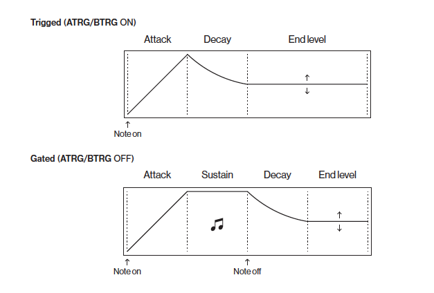

I couldn’t see the logic for the end level in the envs. This is my thinking: Just set sustain as the “end” level and a fast release so it’s ready for the next note. Maybe you can see an advantage and if so I’m all ears. But I don’t get it.

The Operator EGs have both 'Trigged' and 'Gated' modes. In the Trig mode it's as you describe, but in Gated mode (as I understand it) it's really an ASR envelope because what they call the 'Decay' segment doesn't start until Note off, so it's actually Release, except the envelope returns to a preset level, not always 0. This way a timbre can drop to a less bright sound fairly quickly upon Note off, but then remain there for as long as the final Amp envelope is Releasing. This was something the DX7 EGs could do, but not the simpler ones in the 4-Op Yammys.

Ahhh! I think I can see it now thanks.
I’d actually forgotten about the final overall amplitude envelope. When the final env decays to zero and finishes, the channel would close and you wouldn’t hear the other envs reset to zero. Clever!
