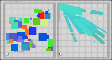

by hardwarehost
Snap 2021-11-28 at 00.38.58.png (13.56 KiB) Viewed 27943 times
I searchd the forum and found the View Cache module by Trog, now it fills all area forever or draw the line from moving object.
added xy "drawing" pad
Random Graph _32hwh 5 still.fsm
(824.8 KiB) Downloaded 1343 times
