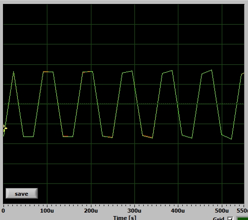

Re: What's the secret of high frequency harmonics?
"...Definitely, the analog realm is a better place for this auditory test, but it is not for any lack of FlowStone to be able to reproduce high frequencies with accuracy (I'm not clear on why you think this)...."
Hi Chris,
Here's a screenshot of the hookup you included, which is Martin's sine wave osc.
At 11kHz. this is what Flowstone delivers.
There are "shortcomings" to digital audio, sure, and I can't say for sure if this is a Flowstone issue, soundcard issue, etc., but this is what my 'scope shows.
I could discuss this further but I don't want to attract any 'experts' and have an instant replay of last week.
Bottom line ?
I wish I had my analog lab gear from decades ago, we could run the experiment that way.
But my 700 sq. ft. apartment says "so more room, son".
Best regards,
ROXY

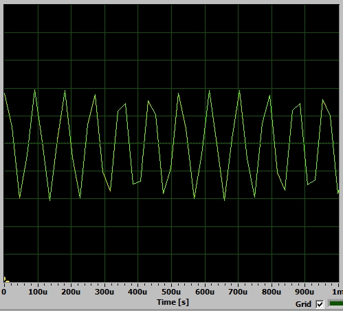

Addendum....
Hi Chris,
Here's a screenshot for comparison, my Wavetable generator processing a 1024 sample sine wave at 11 kHz., 12 dB down.
Quite a difference.
This waveform shows odd and even harmonics, <80 dB down.
Flowstone ?
Soundacard ?
Not perfect, but at 11kHz, not too usable musically, so it's of no concern to me.
(The triangle wave at the beginning of the trace is caused by the one shot 'grab' made by the 'scope.)
ROXY
Showing the details of a waveformat high frequency has nothing to do with Flowstone. This is no mystery, it has to do with samplerate. I recorded a square wave at 10Khz at 192000 samplerate, then at 44100. You can see that 44100 has less samples per second so the data points show less of a square. Simple as that.
