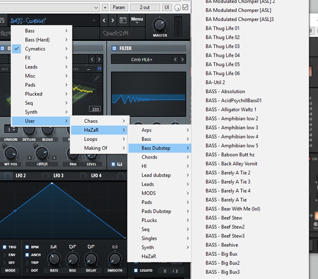

So, say you make a VST with some default presets,this preset manager is set to open a fixed folder User -Documents-VSt-Presets. The user then makes a new preset and saves it , all is fine so far.
But when the user opens up the vst again he is back to only the defaults and none of his own presets.
I realize that you cannot write into the Dll but there must be a way to autoload all presets on startup in the daw ?
Assuming you use a fixed folder.
Also, lets say that you want to use Grouped presets.
Bass
Synth
Fx etc .
And the user might want to add a group , could the preset manager be told that each folder within the specified main folder is a group and then show any additional folders made by the user? And even groups with those groups ?
This is how it works in for example Serum and is very convenient.
