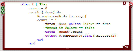

Well - now always these little problems...
I cannot exit this each do loop
It always run's until it's end.
The count shows immediately the max events.length!
It doesn't matter whether i use catch/throw or break...
Is there a trick with raising an error or something else?!
- throw or break doesn't work here.png (330.85 KiB) Viewed 19538 times
Re: how to send Midi Message
I'm not 100% sure, but here are some thoughts:
(1) break would have been sufficient. That both don't work, seems to point to '@plays' being the cause.
(2) each is a closed loop. It will be executed exactly at the time it is called. There is no connection to the external world (which means everything outside of 'when 1')
(3) if @plays happens to be an input, then .each will not be aware of any changes to the input until .each is done and Ruby is given a chance to peek at the inputs again.
(4) In case (3) is true, you need another way to loop through (for example scheduled inputs/methods), so that @plays is checked for its current state in each iteration.
scheduled inputs/methods => Ahh - i see... had this in an older project - will try my best here...
Thanks 4 the hint!
Scheduling a method is straight forward. For this example, create a boolean input for your RubyEdit and link it with a boolean prim set to false. Then paste the following code:
Now switch the boolean prim to true and wait two seconds. As you can see, the event occured right on time, but the method is executed 2 seconds later (t + 2).
For your task I would go with scheduled inputs. I've attached an example.
Thanks again Tom - will be a long night
Hope i get no Midi Timing probs...
Keep on Doing!
=> Short Report...
Got it now
But this idea of breaking into the playing loop is really bad...
How could i know when to stop and which notes Off 2 send?!
Could do this with an array and send the corresponding ones...
a way to heavy task now - only wanted a quick record looper
for some controller CC's/Notes => this works perfectly, so - I've done it!
