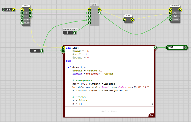

@Youlean: what's the real purpose (here) on using Redraw Area instead of Redraw.
For what I see, both Redraw and Redraw Area call the "draw" function defined for that View in the linked Ruby codes.
Even if I use one or the other, the def draw i,v function (defined inside the Ruby script that draw the waveform) is always called. This means that every cursor movement (processed by Tick25) redraw also the Waveform (which it shouldn't, since the data inside it changes only when I send to it different [F] values). Also graphically, I can't see any difference with Redraw or Redraw Area.
What are you tried to show to me here Youlean? I don't get it...
Said that: is there a way to avoid the calling of the ruby "draw" method using Redraw module? In this case, at every tick I should redraw only "Cursor" Area, not Waveform, even if both are linked to the same View:
As you can see, the float linked to the output of Ruby component is incrementing at every tick, because the def draw i,v function is being called (and I'm using Redraw Area; with Redraw its the same).
redraw exclusive.fsm
(15.5 KiB) Downloaded 931 times

Unfortunately I don't understand Ruby.
Actually I have done some test and it seam that Redraw and Redraw Area are the same if you don't redraw smaller area than view.
If you wan't to optimize your redrawing of line your can do two things if waveform is static:
1. Redraw only area little before and after line. This is quite tricky to implement because of redraw skipping some sections...
2. Render waveform to a bitmap.
Or do both for ultimate performance!

Youlean wrote:Actually I have done some test and it seam that Redraw and Redraw Area are the same if you don't redraw smaller area than view.
Can you show to me a little example? Here looks always the same...
Youlean wrote:1. Redraw only area little before and after line. This is quite tricky to implement because of redraw skipping some sections...
:shock: What do you mean with little area before and after line? The cursor?
Another idea I got is to link another prim to Waveform Ruby, and only when I got that value redraw cursor, and literally "return" the function (maybe with a flag variable) before redraw again the waveform (which the code is after the one of the cursor). Uhm...
