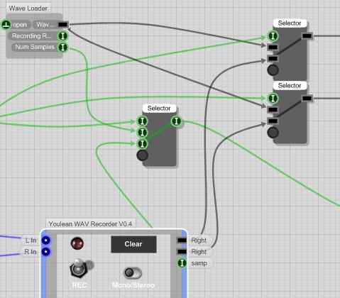

Re: Unlimited Size WAV Record V0.4
I need stereo-sound, and it must be very simple, to save the recorded file as stereo and get it as a stereo array back in flowstone, because I want to switch between recorded and prerecorded material in the scratcher... I posted the "scratch" project in another thread.
1000 Thanks
Martin
1000 Thanks
Martin
- wavrec.jpg (32.75 KiB) Viewed 28685 times
