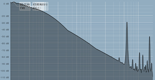

As KG suggested, I tried it with the waveplayer. The result is the same, that means the problem is in the wave itself, not in the code. That's how it looks with the standard waveplayer (linear interpolation):
Making the wavetable bigger is not a solution, because it takes more time to generate the wavetable and also increases the size. The problem would still be there but at lower frequencies. I would rather like to know what is causing this, to fix it for any size of wavetable. I assume it's caused by the highest frequency in the wavetable (from the measurements), and that's why zeroing it get's rid of it. But I have to zero more frequencies to get rid of the imaginary parts in the iFFT as well.

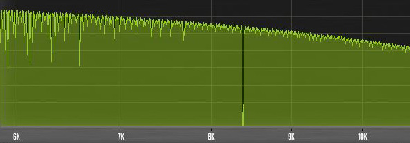

Maybe there is something wrong with MAnalyzer... SPAN shows a notch instead of a peak. At least that would make more sense.

I also observed notch with frequency analyzers made in FS (with range boosted to 150dB and fairly large windows)

I bet on analyzer. Consider this. With analyzer - you are using certain FFT resolution and logarithmic view (or - FFT steps don't match peak steps). Which means, that at higher frequencies, peaks from saw - accumulate and are calculated as a sum. Because this is nonlinear process, it should produce quasi peaks and holes, and it will look like a pattern. Graphical data also must be calculated "somehow", so there you have another interpolation set.
It's like observing amplitude modulation of a sine. At low resolution, you have one peak, that behaves strange (fluctuates and gets a sort of hole from time to time), and at high resolution - you have 2 (or 3, depending on AM mode you use) distinct peaks.
I played with analyzer I use a little bit, and at least I noticed, there are places where saw peaks merge, as a result - producing a spectrum that has variated amount of visible peaks in certain spectral areas.
So the first method here would be - to use exported audio signal, rescale it down, and using spectral window - play various ranges of the spectra. 40dB of difference is a huge range in audible levels. The audible distortion would be really nasty.
