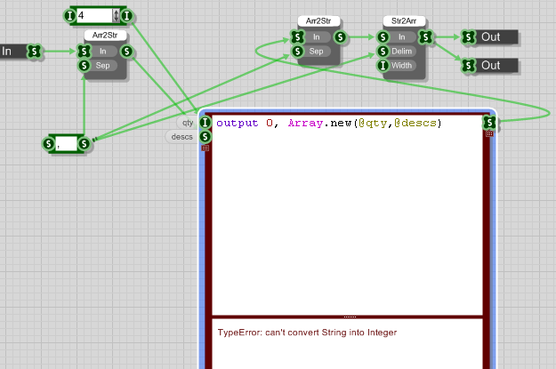

tester wrote:Is there a problem with ruby component between 304 and 306?
They've changed the init phase. Now init is executed after inputs/outputs are loaded. Maybe that causes problems in your schematics. What kind of error are you talking about?
Re: FlowStone 3.0.6 PEBBLE (any bugs or issues)
Things like this. But also other error messages in other ruby boxes. When I click on input node - it reinitializes and resets the error, but after doing the export - error is back again.
It's a spooky thing. As if something was frozen "in the air" between inputs and outputs. I can reproduce it when copying faulty modules into new schematic, but it disappears completely (I think so) after connecting to fresh data node (but it isn't disappearing when I just pass through new data in old schematic).
i can confirm the same issues, but a after load trigger on the string in should solve it ..
in general some clearification would be helpful, it looks like that the persistance of the ins and outs isn't stable anymore?
Nubeat7 wrote:i can confirm the same issues, but a after load trigger on the string in should solve it ..
AfterLoad trigger may help, but watching how the thing behaves (errors after exporting application) - I'm not sure if in all cases. Maybe 1-time copying/refreshing/repasting modules would be better. I will try to isolate a unit, so that I can report it to Malc, because I'm not sure how problematic it may become in future versions of FS.
(btw, using AfterLoad would require some redesigns, to avoid wandering triggers where they are not welcome; on the other hand I remember I could crash FS just by copying some ruby modules that were stuck between S&H prims, so... no time for such experimentation right now, I'm late anyway).
I extracted few portions of the problem and reported to Malc.
