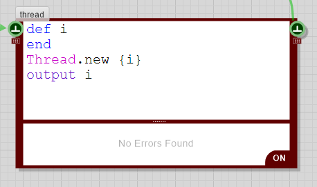

Re: ruby keyboard
awesome, will run it now.
I think it may be possible to live with this selector glitch.
I'm not going to change all my selectors to Ruby I guess.
Anyway, I'm trying to thread and get around it,
does this create a trigger thread?->
There's some weird behaviour that will not allow a 'trigger thread' component
to open the old dropdown module

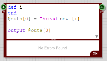

Re: ruby keyboard
little update.
This ruby threading method works!
Here is the working codebox->
Here is a modified dropdown->
Cooool!
Cooool!

Re: ruby keyboard
Your "thread" is to prevent loop repeating right?
If so then this doesn't work on any of the midi keyboards I currently have, the looped audio still remains.
So far the new ruby selector and routing matrix (with a little connection fix) works fine with no problems.
I'm near enough finished with the preset manager too, as soon as I have finished them I will upload them all in one schematic.
