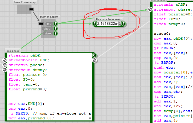

KG_is_back
- Posts: 1196
- Location: Slovakia
Re: Prototype - Free running poly oscillators
the pointer module should output nonzero value.
- memtop.png (57.99 KiB) Viewed 34274 times
