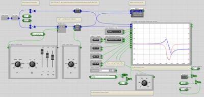

Phase plot now added.
Added a correlator (easy as this is a Flowstone primitive).
D.U.T.is a fully parametrable IIR BiQuad.
See attached .fsm
See attached .fsm
- FFT-based Audio Analyzer_GreenLines LinLogF_ IIR BiQuad Q 0.707.fsm
- (266.22 KiB) Downloaded 1519 times
- FFT-based Audio Analyzer_GreenLines LinLogF_ IIR BiQuad Q 0.707y.jpg (24.87 KiB) Viewed 31655 times

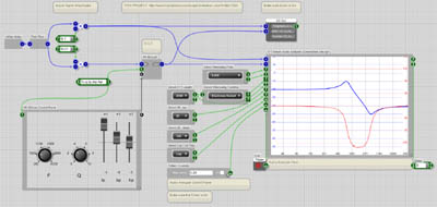

Added a delay compensation for the phase plot.
See attached .fsm
See attached .fsm
- FFT-based Audio Analyzer_GreenLines LinLogF_ IIR BiQuad Q 0.707y.jpg (25.29 KiB) Viewed 31645 times
- (259.62 KiB) Downloaded 1486 times
