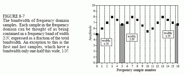

Re: Weird built-in GraphFF Magnitude scaling
Actually I've never heard of this half band problem before. I've been using FFT already a very long time and also done some code conversions and never notice that there is a special adjustment case.
I think it's because the DSP Guide is talking about DFT and not FFT. The difference is - beside that the DFT is way slower - the DFT outputs N/2+1 samples, while the FFT output N/2 samples. So this additional sample in the DFT is the one, that get's split. I don't know exactly, but as I said, I've never heard about that band problem before and can't find anything about that problem in combination with FFT on the net.

@MyCo : you are not the first and the last one, getting trapped into this. You need to remember that the FFT is a particular DFT implementation, speed-optimized, running on time-domain samples organized in powers of two. Thus, what Steven W. Smith writes about the DFT data formats, remains valid for the FFT data formats.
The National Instrument documentation at http://www.ni.com/pdf/manuals/322194c.pdf confirms what I'm saying. This is LabVIEW Sound and Vibration Toolkit User Manual, April 2004 Edition, Part Number 322194C-01. On page 10-5 and 10-6, it reads : "For example, if 1,024 samples are input to the FFT algorithm, the computed spectrum has 512 non-DC spectral lines. The computed spectrum has a total of 513 lines including the DC component."

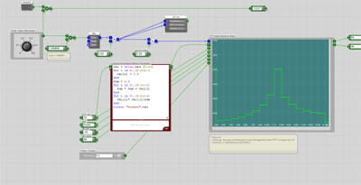

Things are progressing. See attached .fsm.
- FFT-based Spectrum Meter (normalized Rectangle window)(FFTmagbugfix)(Lines01).fsm
- (22.69 KiB) Downloaded 1409 times

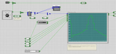

Just added flexible windowing.
Can somebody check if this Spectrum Meter can be considered as accurate?
See attached .jpg and .fsm
- FFT-based Spectrum Meter (flexible windowing)(FFTmagbugfix)(Lines).fsm
- (19.08 KiB) Downloaded 1376 times
- FFT-based Spectrum Meter (flexible windowing)(FFTmagbugfix)(Lines).jpg (21 KiB) Viewed 30042 times

dB grid is now automatically managed, using the dB_range parameter
see attached .fsm
see attached .fsm
- (19.11 KiB) Downloaded 1407 times
Looks ok to me. The fix seems to work, although I don't know why this is needed. Believe me, the devs done nothing to the FFT code. I think they use a straight forward implementation, like we do for the stream fft. There is no workaround in it. You can compare the FS FFT output with one of the free calculators on the internet, and they'll output exactly the same.
