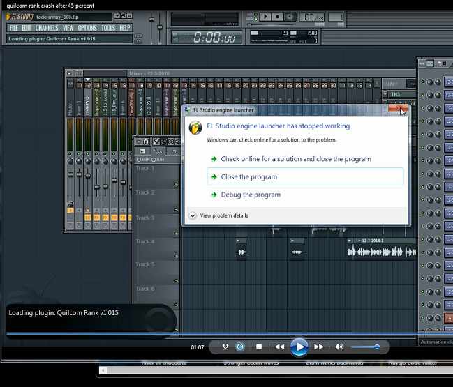

Hi Spogg. Just so you know I'd made a FDN Reverb as well. And it wasn't until I loaded a project up to the point of over 50% CPU that I came across a bug with My own FDN reverb based on Martin Vicanek's schematic crashing.
I solved that by replacing the MV optimized Troggludite non-interpolated (simple) delay with the MV simple delay. It was more stable as a result but used .5% more CPU. Maybe that's of use to You if anyone mentions it.

Confirmed after 45% CPU usage.
intel core 2, 3.33, 8gb Ram within FL Studio.
Crashes while loading within an already opened project
I was able to fix by removing Trog delay as I mentioned but also I replaced all instances of ASM optimized stereo pack. For the sum and features I hooked up a normal pack in the right configuration.
Tonight I'll try that and let You know if it needs anything else on My end.
