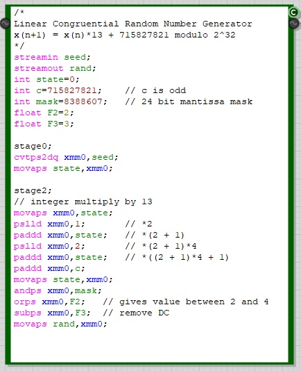

Me and ASM :roll: I can't even manage the simplest things it seems :lol:
I'm trying to add a reset to MV's noise.
Original noise asm...
Being reasonably short ASM. Looking at it I thought it would be a simple way to just squeeze in a few lines in there. Similar to sync's for oscillators.
// Any potential floats and stage0 additions excluded
movaps xmm1,sync  //sync = polystream input;
cmpps xmm1,F0,6;
andps xmm0,initstate;  //initstate = copy of state at stage0. In other words "cvtps2dq xmm0,seed;"
movaps state,xmm0;
But clearly I don't understand the fundamental workings of ASM :lol:
Maybe someone can help me, or point me in the right direction. "At best" I just ended up getting any value I replace xmm0 with as constant output :)
Btw wen't through KG's info documents. It goes from 0 to 100 pretty quickly :D But nice guide nonetheless.

Posted: Thu Sep 14, 2023 1:26 am
by Tepeix
It's not so easy to do. Specially with the limited set of asm instruction of 3.6 version.
The problem is that you need to modify an int.. Then you could no more use addps, subps that are for float.
But in 3.6 when using paddd (the int add) we need to use a variable and not a register.
Not paddd xmm0,xmm1; but paddd xmm0,x; and no sub.. So it's complex to reset an int with a condition..
I find some way but they might exist better with more advanced version of flowstone.
Way1: use skip in asm, but it need to be done four time, as i suppose that you want to reset each voice independently..
Way2 is more experimental but seams to works.. We could not reset the int state to a value, but we could reset it to zero. Then we add the initial state0 every frame of the random process..
(But now maybe it's not really true random unless we use even number as seed ???)
