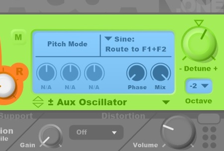

Moreover, the math in MV's version had a bonus up it's sleeve... that made it a "two for one".
Seems i'll get yet another oscillator style from the same modules. Interesting! :P

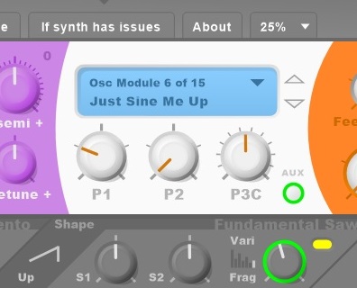

Almost, but not quite the Split Exp...
Became so curious "I just had to try" when I found this module that MV made for the PWM SineGenerator
:lol:
Doesn't output the correct way like MV's and Tepeix Split Exp modules do. But was a fun test...
