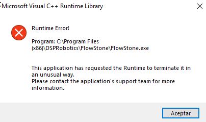

this past week I started getting this error while working on FS 3.0.6 :
Visual C++ Runtime error
2021-01-18 01_46_46-Microsoft Visual C++ Runtime Library Error.jpg (16.25 KiB) Viewed 40834 times
and today it happened again so i uninstalled all Visual c ++ Runtime versions and reinstalled them, upgraded with windows update and so far FS 3.0.6 is working fine,

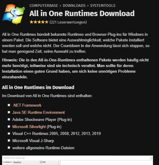

(this is the installer i used to reinstall visual c ++ versions):
the aio-runtimes v2.5.0
2021-01-20 00_55_32-All in One Runtimes - Download - ComputerBase.jpg (55.88 KiB) Viewed 40834 times

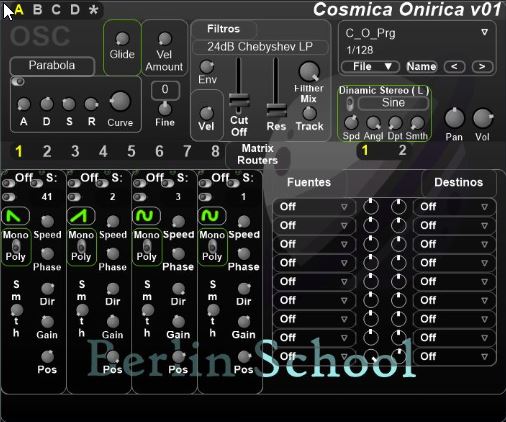

my project <3
my project <3

The following is an alternative freeware AIO
Microsoft Runtime Libraries installer ...
This is the 'American English' version.
Win 10, 8, 7 (32-bit & 64-bit)
Visual C++ Redistributable Runtimes All-in-One Mar 2021
Download Link:
https://www.techpowerup.com/download/vi ... ll-in-one/
FIlename:
Visual-C-Runtimes-All-in-One-Mar-2021.zip
First, 'right mouse click' and 'unblock' file ... Unzip file and run ('double-click')
FIlename: install_all.bat (do not run as administrator)
