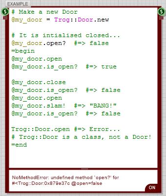

Hmm,
did i miss something?
when i open ur
NoMethodError: undefined method 'open?' for
#<Trog::Door:0xa9a74f0 @open=false
when i open ur
i always get the error:Simple Class Door.fsm
- trogluddite
- Posts: 1730
- Location: Yorkshire, UK
Re: Ruby namespace best practice.
Yes, that's right - I was demonstrating why Tronic's 'class method' style call would not work for an instance method - as in the comments...
I understood... but even now?
- Class door.jpg (28.39 KiB) Viewed 16320 times
- trogluddite
- Posts: 1730
Aaah - now I see!
Didn't read my own API docs! - the correct method is, of course "is_open?" not plain old "open?" - D'oh!
