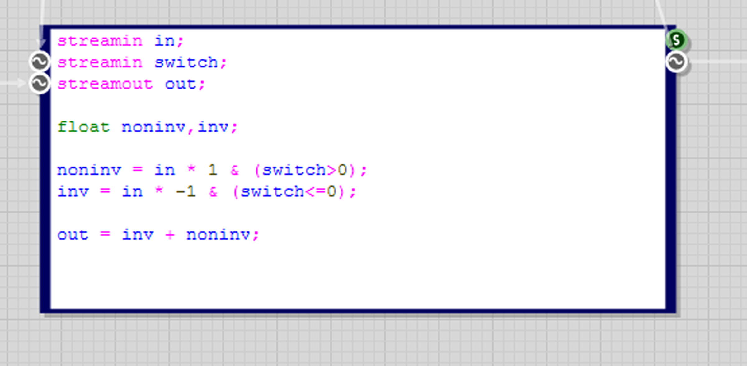

Here's a poly stream-controlled inverter I knocked up, together with a demo test synth attached.
DSP box.png (288.21 KiB) Viewed 25709 times
I wonder if this could be made more efficiently in DSP code...

Hey Spogg,
thanks for participating! Interesting question. I came to the conclusion that basically you only care for a sign switch (positive switch input = +1, negative switch input = -1). I always look at all modules, Martin shares with us. In the past, it didn't help me the slightest bit. But now that I slowly start to understand the dsp editor, I remembered that I once saw a sign bitmask in some of Martin's modules.
sgn = -1&-2 //sign bitmask defined in stage 0
I have no clue what exactly is happening to the bits, but I know what a sign function does in higher level programming languages. And since it is a bitmask, I knew I had to somehow bitwise combine it with the switch. After several tries, I came up with this
1|(switch&sgn) //results in either -1 or 1
The final code then looks like so:
What do you think? And what do the DSP gurus think?

Yup, tula's inverter does the same as Spogg's and is more efficient. ;)
It is probably not meant to be used as in the schematic because it aliases quite heavily.

Hey well done tulamide! :ugeek:
Nobody noticed I got the inv and noninv names crossed, not that it matters for the result.
My first attempt was to get the whole job done in just one line of code, but I failed to find a method.

tulamide wrote:
sgn = -1&-2
There is actually an even simpler method to get a sign mask in dsp code:
float signbit = -0;
Unfortunately you can not use xor in dsp code, otherwise one could simplify the code to
out = in ^ (switch & signbit);
This is why I don't like the dsp code module, it is limiting because it doesn't have all the features and the generated asm code is poor.

TheOm wrote:There is actually an even simpler method to get a sign mask in dsp code:
float signbit = -0;
Cool! :ugeek:
Do you happen to have a simpler expression for the abs bitmask as well?

martinvicanek wrote:Do you happen to have a simpler expression for the abs bitmask as well?
No, unfortunately not without using stage0. I don't think there's a way to type NaN in the code module, is there?
Assuming the ^ symbol means XOR it'll be available in the 3.09 release according to the list I have. The DSP code will be extended considerably.
