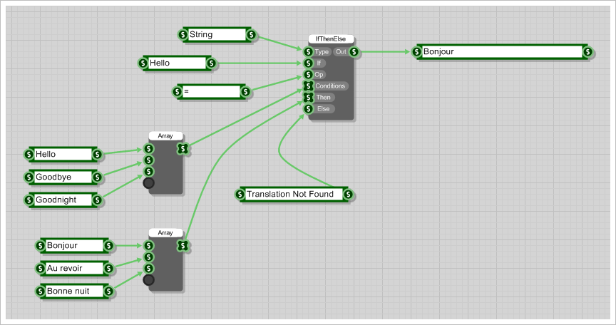

HI!
I'm new with flowstone and would need an example of using ifthenelse.
Thank´s

Try this:
If Then Else Translator clip.png (52.99 KiB) Viewed 15788 times
If Then Else Translator.fsm
(423 Bytes) Downloaded 1397 times

thank you, Embended! I will try it!
