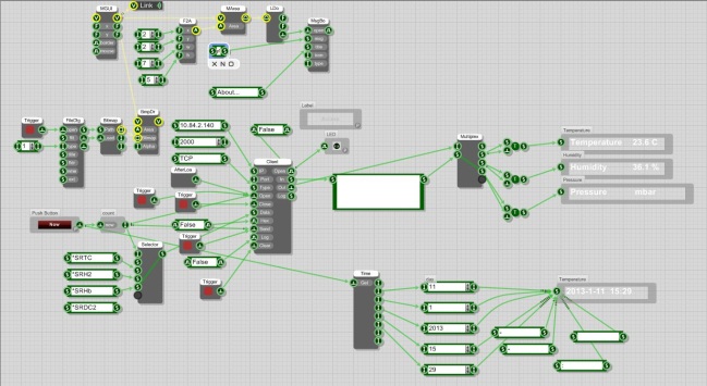

It has been a while but finally it succeeded.
It is in the manual, but when reading it you might not notice.
For people who have such a device and like to experiment with it.
The commands to send to read out the sensor need a * in front of it:
*SRTC to read out degrees in celcius (*SRTF for fahrenheit)
*SRHb for pressure in mbar
*SRH2 for humidity in %
etcetera.
Then it won't give a time out. so simply use the network module, add the port 2000 and the ip nr you've programmed in the sensor/server and send the text command.
see picture
regards.
