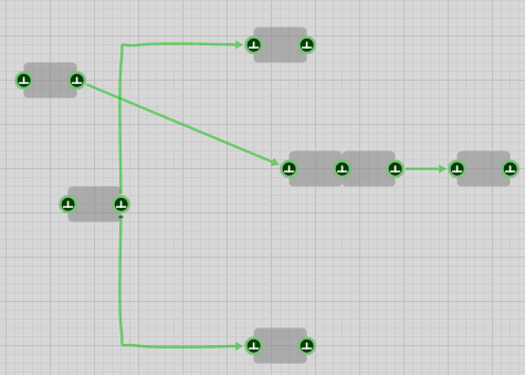

square corners.png (15.11 KiB) Viewed 27552 times
here is a trick-
if u put 2 dots/spline locators close to each other u can make square corners.
U can also dock nodes like in the shot.
IMO-use all the nodes you want.
It can be easier to route things if you have used a dummy/node
