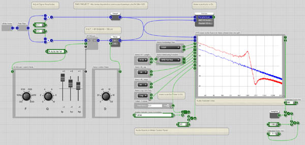

Updated version.
See attached .fsm
See attached .fsm

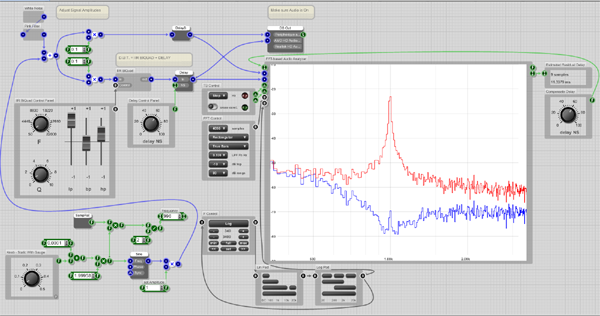

Just added more Graphing features, using Ruby.
Thanks MyCo for helping me in some critical areas. MyCo determinant contributions in this particular project are :
- Efficient IIR filtering on an array, using Green code. I found this truly amazing. It opened my eyes, about Synthmaker/Flowstone capabilities. This is in the LPF Fb Hz section. I took MyCo 1st-order LPF and reworked it for implementing a 2nd-order LPF Butterworth, with a variable -3dB frequency.
- Elegant distributed control using a ring Bus. This is in the Frequency control surfaces : F Control, Lin Pad, Log Pad.
- Efficient Ruby error avoidance fix, bypassing any routine that is supposed to manipulate an array, if that array is still "nil" at execution time. This way Flowstone can still generate random triggers during initialization, without Ruby complaining about "nil" issues. This is in the Ruby Draw section, where we draw the gain, the phase, and the estimated impulse response.
Without MyCo, the user manual, the trogluddite "Trigger Tutorial" and the STEM Example Projects from Admin, I would be still nowhere.
Feel free to use and abuse this FFT-based Spectrum Meter. I'm interested in users feedback.
Check also the FFT-based Audio Analyzer here http://www.dsprobotics.com/support/viewtopic.php?f=3&t=1524&start=20
Many thanks, again
Steph

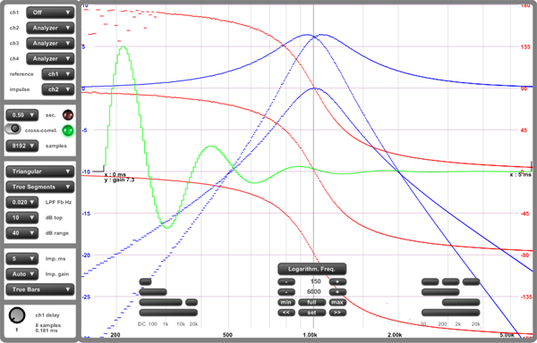

The FFT-based Spectrum Meter is now part of the FFT-based Audio Analyzer
http://www.dsprobotics.com/support/viewtopic.php?f=3&t=1524&p=6857#p6857
Four signals can have their spectrum displayed, simultaneously.
