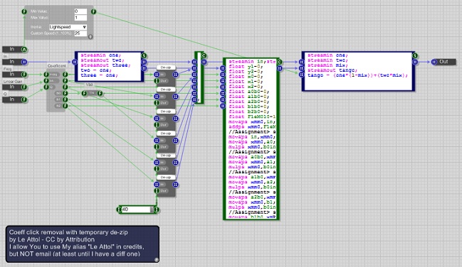

Hi all, I was working with alternatives to using the de-zipper. It comes down to the LP dezip method sounding the cleanest yet a bit un-natural, and the older methods of dezipping using the incremented timers probably the nicest - but I mean for speed there's nothing better than the newest de-zippers.
So to that end I was working on a 10 band equalizer. While I was finishing up work I had done on co-efficients I was wanting to remove the
crackle noise I was hearing when I manipulated the low end (62 Hz and downwards) so I came up with this method.
62Hz click removal
62Hz click removal
click removal.jpg (103.05 KiB) Viewed 14329 times
And what it uses is the following:
two identical co-efficient assemblers and dsp coded splitters (code in the image).
