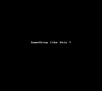

You mean the wet/dry knob ?
lalalandsynth
Posts: 600
Re: Single knob/button Equaliser
Post by lalalandsynth »
Like this ?
lalalandsynth
Posts: 600
Like this ?
I would share the schematic but i am working on another version of FS, hope this helps.

Alexdiguardo
Posts: 9
Joined: Sat Sep 22, 2018 8:46 am
Post by Alexdiguardo »
Yes, Martin helped me out with that in a similar way.
The vst is ready now, tested and works wonders. I'll link a demonstration video soon!
