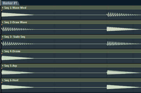

Sorry guys, but all of my designs have been proven in-accurate.
They start drifting after a few minutes and continue to drift with time.
before and after 5 min
Look at the black line(host marker) in the background
And look again
So the timing issue is not dead- the dead horse is not only alive, but has bolted
from the scene.
So the headline "Ruby delivers ", for me, is FALSE.
Ruby has not delivered. Why?...

here's the first test result:
At start
At about 5min
Give me a day or two, to test in other hosts and verify.
Will upload then.
Sorry if i gave anyone a heartattack. thanks for your patience.
