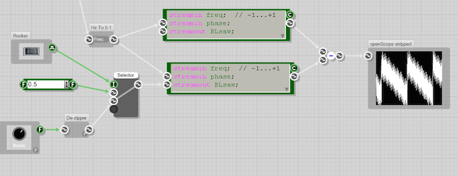

Since I'm the dope without FS, let's do this the other way 'round. Here's a schematic of my situation. With a 0.5 float - perfect square, with a PW control, a saw on acid. Maybe it's not the same saw you guys are using.

In general, is there an advantage to doing PWM with a steam subtract rather than mixing the phase-shifted saw through an inverter?
It's the same thing.

The problem in your schematic was a faulty phase implementation :oops: Fix attached.

So!- the code I had was different; I thought I'd lost my marbles. Thanks so much for fixing that.

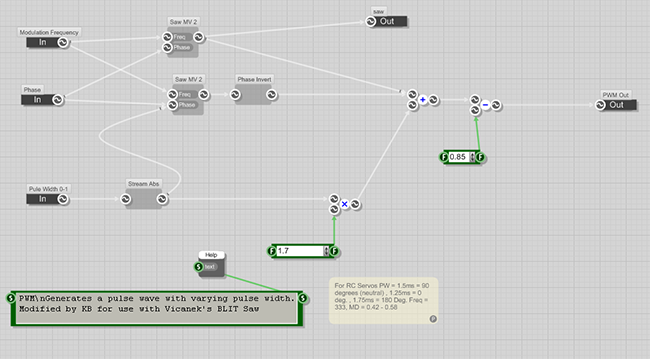

The DC problem you mentioned - is that also true of the 'fancier' PWM shown the schematic at the top of my post? That one also maintains a centered waveform at all pulse widths.
So, I tried your saw with the 'fancy' pwm (stays-centered) method and it didn't work! I noticed your oscillators have a different phase relationship to the stock oscillators. Here's how I modified the PWM to work with your oscs.
Centered PWM wVicnak BLIT Saw copy.png (109.7 KiB) Viewed 28506 times
Does this have DC on the output?
You can easily measure DC by placing a lowpass with sufficiently low cutoff. ;)
